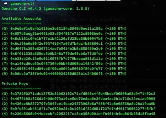

Step 1: Start ganache enter image description here

Step 3: Write code (take addresses from ganache available accounts)

  • I enter the ganache-cli command, after which I get 10 accounts. How do I continue to work with these accounts? Are these accounts stored somewhere? – Ayurpwnz Nov 24 '19 at 12:13
  • when you run ganache-cli you can use -m "use your own mnemonic just a random set of words" -- this will make it so you can get the same accounts / private keys every time. At this point I'll usually just hardcode the addresses / private keys as configs (this is insecure and just for dev purposes). You can also get accounts programmatically web3.eth.getAccounts().then((accounts) => console.log(accounts[0])); According to this - https://ethereum.stackexchange.com/questions/60995/how-to-get-private-keys-on-truffle-from-ganache-accounts you can get private keys too but never tried – Steven V Nov 24 '19 at 14:26
