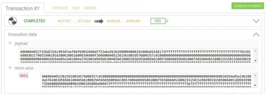

Yes, it is normal and the code on the blockchain is always a subset of the compiled (byte)code, because the compiled code includes initialization code. The compiled code is/executes a function which returns the blockchain code, but as part of the execution also initializes the contract being deployed.
For your contract, look at its transaction 1 and you can see the invocation data, the payload and the return value. The compiled code is the payload, and executing it produces the return value.
Related: How can I verify that a contract on the blockchain matches the source code?
