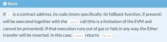

Attention: If you implement the fallback function take care that it uses as little gas as possible, because send() will only supply a limited amount.
