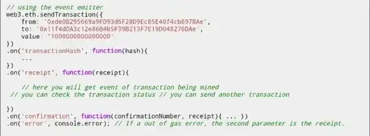

If you are using web3js 1.0, you can fix it quiet easily. In web3js 1.0, you can listen to the event of the transaction got mined into the block. So after that you can send next transaction based on the success status of the mined transaction. This success status you can get from the transaction receipt of that particular transaction. But, point to be noted that before getting mined in the blockchain, you will get null as transaction receipt if you explicitly call api to get transaction receipt.
The way of tx sending you can follow according to the given pic. There, in on receipt received, you will send your next transaction. The same process will be triggered for the next transactions.
To get further explanation, go through the link below https://web3js.readthedocs.io/en/v1.2.1/web3-eth.html#id64enter image description here
