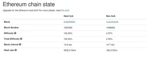

From http://fork.ethstats.net/:
The non-forked chain (Ethereum Classic / ETC) does not have many clients or miners and you would therefore experience the slow syncing.
