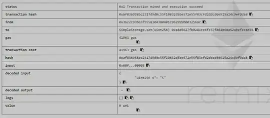

I want to call the SET function of this contract and immediately get the recently assigned value returned without calling the GET.
Therefore, I return the value I just sent. However, this does not seem to work.
What I get returned is:
Returned Values
Take note that the value of decoded output is empty.
Is there a way to let the SET-Function output the value it just assigned?

    They return, but you can only use it on-chain (i.e., when you call the function from this contract or from another contract). When you use it off-chain (i.e., when you call the function from a web3 client), you get the transaction receipt instead. In order to know what the return value was, you need to emit an event from the contract function, and that event will be available to you in the transaction receipt. – goodvibration Aug 09 '19 at 13:37

The value is actually returned, but we just don't have a way to get it with web3 libraries yet. Think about it: how can your client get the return value if it has no clue when or if the transaction will be included in a block.
Luckily for you, there's a solution. It's called "Events", check it out: https://solidity.readthedocs.io/en/v0.5.10/structure-of-a-contract.html?highlight=events#events
