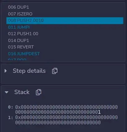

Although this is an old question here's what I found on debugging further. As @haxerl explains above it looks like the only purpose of ISZERO is to check if the top of stack is zero. How does it do it? It does a simple not operation on the last number as seen in the screenshots below from remix
Before After
