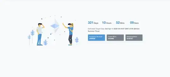

I am in need of a library that estimates a date or some sort of timestamp when fed with a future block number (on mainnet or any major testnet).
For instance, https://etherscan.io/block/countdown/9950000 shows up like this:
Etherscan Countdown
Unfortunately, I emailed Etherscan and the countdown feature is not available in their API (I probably could reverse engineer it by parsing the HTML response, but seems overkill).
Is there any library that does this?
