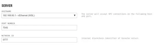

My problem was that I was using WSL2 to run my truffle commands and my ganache GUI is in windows. My fix configures WSL2 with the Windows ganache GUI
What I did was
  1. Restart my computer
  2. Specify vEthernet(WSL) as the ganache server enter image description here
  3. Copy the hostname for vEthernet(WSL) into my truffle.config file for the host field
    module.exports = {
      networks: {
        development: {
          host: "192.168.80.1",
          port: 7545,
          network_id: "*"
Note: Your host for vEthernet(WSL) might differ from mine and differ each time you restart.
