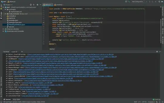

  • I get some errors, can you specify the versions of solc, web3js and truffle-hdwallet-provider? Mine are: "dependencies": { "solc": "^0.5.4", "truffle-hdwallet-provider": "^1.0.4", "web3": "^1.0.0-beta.46" } and I am not be able to run your scripts. – kitsune Feb 27 '19 at 11:37
  • I am not able to run solc.compile(source,1) but using solc.compile(source,1) works, but gives me error about > A valid JSON document must be either an array or an object value.
    Please recheck your answer, this solution is not working.
    – kitsune Feb 27 '19 at 13:01
  • Thank you very much, I really appreciate your efforts: but it still not works, I updated the question with two screenshots. I use the same menmonic and the same address in both cases, but I am able to deploy contracts only using Truffle (same configurations). – kitsune Mar 01 '19 at 15:49
  • Are you able to post your test project to github/bitbucket ? – user3316669 Mar 02 '19 at 08:35
  • Yes, however I am using the exact code you posted in your answer. In addition I opened an issue here: https://github.com/ethereum/web3.js/issues/2446 – kitsune Mar 03 '19 at 20:29
  • When you run the ./compile.js, it’s all ok? When you uncomment the line ,console.log(solc.compile(source,1)); it all looks ok? – user3316669 Mar 03 '19 at 23:12
  • Reading it https://ethereum.stackexchange.com/questions/61901/truffle-hdwallet-provider-not-return-correact-address-when-using-private-key and so I found https://github.com/rhlsthrm/truffle-hdwallet-provider-privkey that solved for me. There was problems about HDWalletProvider. Contract deployed finally. However, I appreciated very much your effort, +50 of bounty are yours. – kitsune Mar 04 '19 at 08:32
