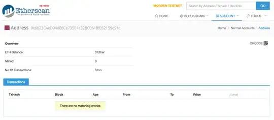

Advised to check the Etherscan explorer I would like to stress I am talking about a situation where I have not mined any block for 48 hours and it shows like this:
Etherscan results
From the screen above (or subsequent links) I cannot see a way to tell if my Mist is actually mining something or not.

You can track block mined by your account on any testnet explorer. E.g. http://testnet.etherscan.io/address/0x8d80fe3a57f2f48bff06db68f3d2c94ea23c88c7#mine.
Testnet is the same technology, but different configuration (e.g. different network number from main network). So the explorer are able to track testnet and main network side-by-side with minimal additional cost.
