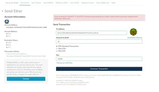

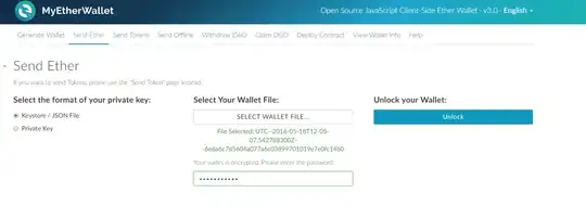

You could use https://www.myetherwallet.com/#send-transaction to send your funds to poloniex
Follow these instructions:
1-Find your keystore file. (%appdata%/Ethereuem/keystore in windows).
2-Open MyEtherWallet and go to the “Send Ether” tab.
3-Select your keystore file or enter your private key.
4-If a password appears, enter your password and then hit “unlock wallet”.

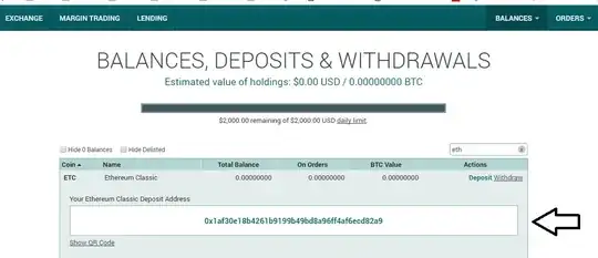

5-then go to Go to Poloniex and get a deposit address.
enter image description here enter image description here 6-Go back to MyEtherWallet and paste that deposit address into the “To Address:” field.
7-Enter the amount to send. It is recommended to test with a small amount first. enter image description here
