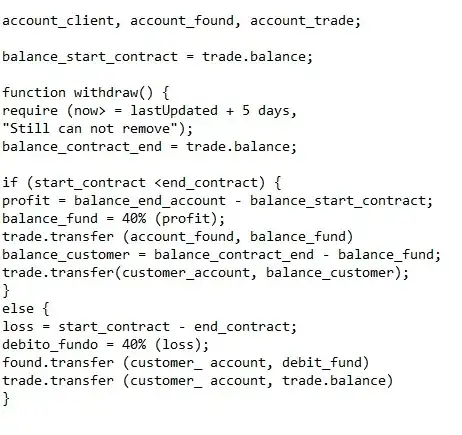

I want to implement something like this: Test conditions for making ethers transfers between accounts. 3 accounts
I am having difficulty with the transfer functions.

  • Got it. thank you. I finally understood that I can not do the way I thought. I think I'm going to have to transfer to the contract, and from it allocate to the due accounts. – Jarbas Lucena Nov 24 '18 at 22:12
There is no way to write a contract to spend from someone else's account. A contract can receive funds, hold funds, account for funds and send funds.
An ATM is possibly the simplest scaffold to think about. "Clients" can deposit and withdraw funds. The funds "mingle" inside the ATM where there is one grand total (funds on hand a.k.a. address(this).balance). The ATM's job is to handle accounting so it releases all the money owed to individuals but no more than it should.

In case it isn't clear, the public mapping means that anyone can check the balance owed to any address. This means Alice and Bob can check the funds held by the contract. They can use the withdrawFunds() function to pull their funds out.
In the case that you want a contract to mediate trade between Alice and Bob, you need Alice and Bob to transfer assets into the safe-keeping of the contract. Then, when triggering events happen, update internal accounting. For technical reasons, it's generally best to use a "withdrawal pattern" as in the ATM example. Alice and Bob would interact with the contract to request their funds if they want to remove them from the contract.

  • I understand, but I'm having a problem with this "mapping balances", it only returns me 0. If I do "balances [add]", it returns me 0. If I do "add.balance" it returns me the ethers value in the wallet. In case, I'm using the remix. The accounts already come with 100 ethers by default. – Jarbas Lucena Nov 24 '18 at 22:09
