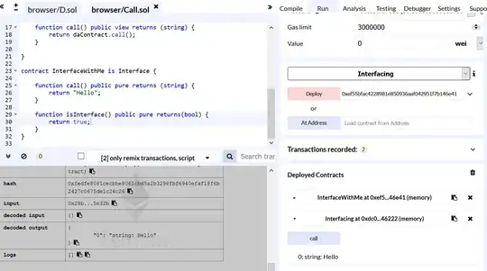

A fair bit of fiddling for readability and style.
pragma solidity 0.4.25;
contract Interface {
    function call() public pure returns (string);
    function isInterface() public pure returns(bool);
contract Interfacing {
    Interface daContract;
    constructor(address theContract) public {
        daContract = Interface(theContract);
        require(daContract.isInterface());
    function call() public view returns (string) {
        return daContract.call();
contract InterfaceWithMe is Interface {
    function call() public pure returns (string) {
        return "Hello";
    function isInterface() public pure returns(bool) {
        return true;
Here it is in Remix to show it working.
  1. Deploy InterfaceWithMe
  2. Copy the deployed address to the clipboard.
  3. Deploy Interfacing passing the address from the clipboard into the constructor.
  4. Call call in `Interfacing.
  5. Hello
Hope it helps.
