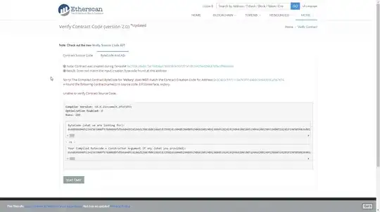

However, the code isnt being verified on https://etherscan.io/verifyContract2 I get the following error:
https://puu.sh/BQMOg/fd3217d62e.png
What should I do, what am I doing wrong? The contract address is 0x3C403c5371113a7d3f91d4b9C9A88333Ca567e74, the compiler 0.4.21+commit.dfe3193c and contract name Victory.

    2) Constructor Arguments ABI-encoded (For contracts that accept constructor parameters):
    Did you supply the ABI code for the constructor arguments?
    – vhie Oct 26 '18 at 00:48
  • I did, still have the same problem. If I compare expected result and my generated bytecode, my bytecode is substantially shorter. – Rok Dolinar Oct 26 '18 at 08:34
  • Have you tried Optimization = No? – vhie Oct 26 '18 at 09:03
  • Yes, but the optimization must be Yes, because that's what my friend did when he created the contract. – Rok Dolinar Oct 26 '18 at 11:12
  • How were the contracts deployed? Did you try different versions of the compiler? You may also try setting optimization runs to 0. – Ismael Oct 26 '18 at 19:36
  • @RokDolinar I tried publishing a contract both with optimization enabled and disabled. I got the same error when I tried to publish the contract with Optimization = Yes when I deployed it with Optimization = No. You might want to review with your friend again if the optimization is indeed enabled upon deployment. This is just my opinion base on my tests. – vhie Oct 29 '18 at 03:03
I successfully verified your contract in Etherscan and Blockscout: https://etherscan.io/address/0x3c403c5371113a7d3f91d4b9c9a88333ca567e74#code https://blockscout.com/eth/mainnet/address/0x3c403c5371113a7d3f91d4b9c9a88333ca567e74/contracts
I think the problem was with the wrong constructor arguments provided. But since Etherscan made the possibility to automatically auto-fill constructor arguments, verification process became easier.
