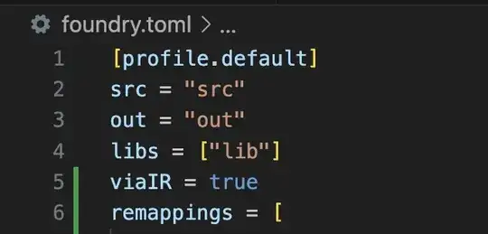

Quick Fix (Temporary) -
If you're using Foundry, then try adding viaIR = true in foundry.toml file. (As shown on line 5)
Compilation might take more time, but you would be able to get the desired results.
For me, solc took around 50 seconds to compile the files.
If you are using Hardhat, this property should be added in the hardhat.config.js in JSON format.
PS: It is suggested to avoid adding this configuration, if you can add more scopes or split the larger functions into smaller ones to limit the variable's lifespan.
