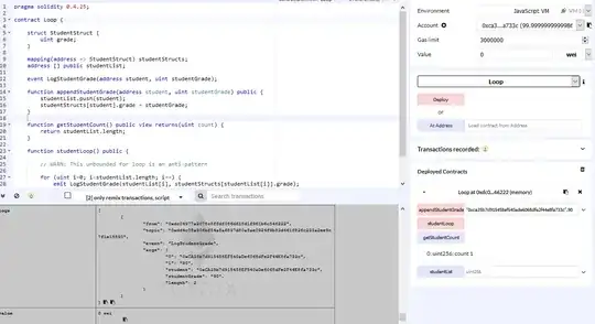

In Remix:
  1. Deploy the contract
  2. Add students, score. Repeat multiple times if you want.
  3. Inspect the count function.
  4. Sent a transaction to the studentLoop
  5. Inspect the transaction Log.
Here it is in Remix to show it working.
Hope it helps.
