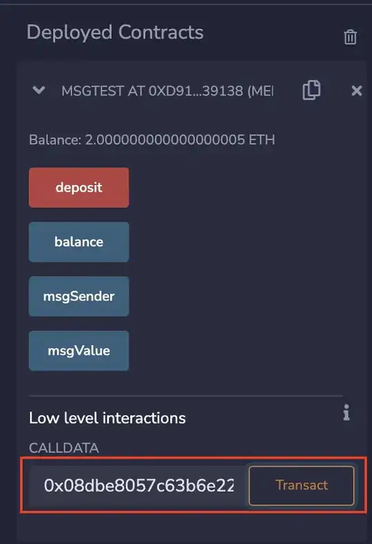

As of 2022, you can send ether to the contract with msg.data. For this purpose, just use calldata area. calldata input area is on the left-bottom corner of the screen and whatever you enter there will be evaluated as msg.data. However, it only accepts bytes data format.

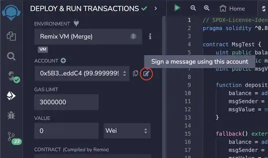

You can use the signature icon beside your account number to sign a message.
(The VALUE input before signing the message will be included in the transaction.)
You can then copy the signed message signature in the Low-Level Interactions field.
Sign message in Remix. Entered VALUE will be included in transaction.

  • The signature part isn't necessary for this answer, using CALLDATA should be enough for this answer. Please, don't copy & paste the same answer multiple times, if the questions are similar mark them as duplicates. – Ismael Apr 18 '23 at 17:16
  • @Ismael Yes, but CALLDATA requires a hashed input, and using "Signed Message" function has been the easiest way that I've found to manually generate a transaction that interacts with the contract. – juil Apr 21 '23 at 13:25
  • @Ismael Sorry, my intention wasn't to imply that the questions are duplicates, but the answer to both of them seem to be the same to me, even if what the asker is looking to do is different. – juil Apr 21 '23 at 13:26
  • The lowlevel CALLDATA content depends on the contract being called. It could be anything, the more common is to use a function call (4 bytes function id followed by the encoded parameters). – Ismael Apr 21 '23 at 16:23
  • @Ismael Is there a way to do that in remix? – juil Apr 24 '23 at 13:17
  • Remix doesn't have such functionality. You could use https://abi.hashex.org/ to encode function calls. – Ismael Apr 24 '23 at 17:18
  • @Ismael Thanks for the link. This is also why I answered in the way I did. – juil Apr 24 '23 at 23:12
