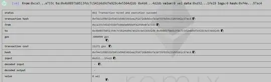

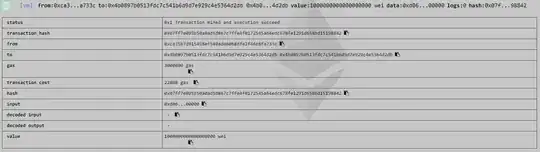

Here are some screenshots for send and receive ether for further analysis. Below is for Sending 1 Ether to the address: enter image description here
Below is for trying to get or view ether sent to the specified address. enter image description here

The other question I have here is why no value is given and the console just responds back with a call to Buyer.getAmount()? Then no value is actually given back. Is this an error or glitch?
