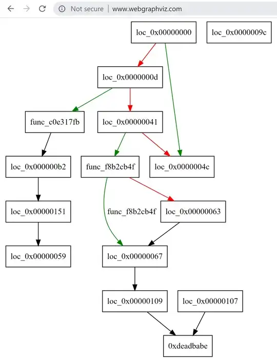

If it is possible to write smart contracts in bytecode directly, then it is possible to read and analyze it. Taking in account that bytecode is similar to assembler with LIFO stack, it not friendly to read. There in no functions' name, variables' name, names are absent at all. Here is similar question about assembler https://reverseengineering.stackexchange.com/questions/10604/how-to-generate-cfg-from-assembly-instructions.
In order to do this I would:
  • learn opcodes http://gavwood.com/paper.pdf
  • check Remix, there is awesome bytecode overview after compilation (can be useful)
  • check project https://github.com/comaeio/porosity to understand how to parse it
    for instance:
    • define locations of opcodes
    • detect possible tags by JUMPDEST
    • detect jumps by PUSH2 0x.... JUMP (can assume as function call)
Beware the result can be different after compiling of same code by different versions of compiler, means control-flow can be different.
Porocity CFG
porosity.exe --code 0x60... --cfg
