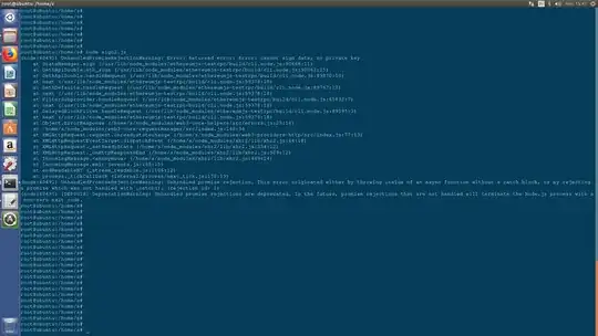

I need to run testrpc before running this code. Now the error message is as follows:
"Error: Returned error: Error: cannot sign data; no private key"
And here is screen shot of the error message :

    The new error is because web3.eth.defaultAccount is null. Perhaps put in the actual address you intend to sign with (the account you've set up in the local Ethereum node). – user19510 Jul 03 '18 at 19:21
    Look carefully at the difference between 0xca35b7d915458ef540ade6068dfe2f44e8fa733c and 0xCA35b7d915458EF540aDe6068dFe2F44E8fa733c. One has the capitalization checksum on, the other not. This is what your original error message was about. – Xavier Leprêtre B9lab Jul 03 '18 at 19:36

    Make sure the account you're using is one that exists in your Ethereum node (geth, Parity, ganache, or whatever). The error indicates that the node doesn't know the private key for that account. – user19510 Jul 04 '18 at 21:27
