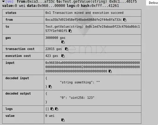

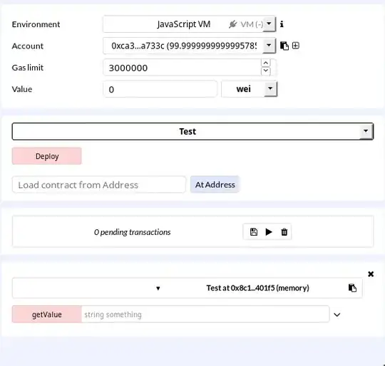

I did copy paste your code and it works fine (although there are some warnings!). Once you deployed the contract (with the deploy button) you can call your function with the getValue button.
You should see the result in the bottom gray box. It shouws the whole transaction and also the decoded output.

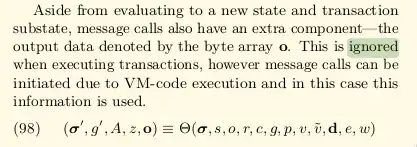

According to the yellow paper:
Essentially the output is used only when the message call is performed by the execution of a contract code. Otherwise, i.e. when the message call is due to a transaction (that triggers the execution) the output should be ignored, as reported.

  • in simple language, if you are returning a value in a transaction (which modifies the state of the blockchain) the decodedoutput field is ignored and left empty. When you call a view function, the decodedoutput field will actually contain the value being returned. This is mentioned in the yellow paper as "This is ignored when sending transactions". See my answer below for a short program that explains this better. – Bharat Mallapur Jun 12 '21 at 10:15
