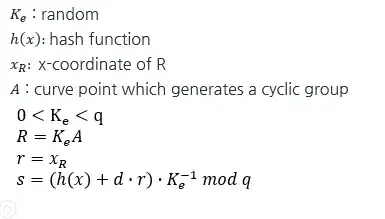

I found myself how to recover public key from tx(signature, r and s) and its address.
First, here is how signature is generated, the public is B, and private key is d, where B = dA. (multiplication on elliptic curve). It is REALLY hard (or simple, because we don't know P=NP or not), so we cannot retrieve d from B and A.
And the public can be recovered as follow, and the number of public key candidates is two, because we only know x-coordinate of R. So it is easy to find a public key which public key is real one from the address.
proof is as follows,
please correct me if something is wrong. It seems that there is useful function in https://github.com/cryptocoinjs/secp256k1-node, .recover(Buffer message, Buffer signature, Number recovery [, Boolean compressed = true]) to recover public key.
