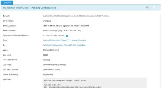

I tried to initiate a sell order for EOSDAC on DDEX - however, i got stuck at the first hurdle in that the transaction from my address to DDEX has been pending for some time. I have enough gas for the transaction.
Here is the reference - 0x2f9d532cb164783c880668275e9c63a7b665037af06fa833fc6d730f57e43b0e

Your transaction is still pending and the estimation confirmation time until it's mined is 13 hours.
Why is it so long ?
The network is currently congested (many pending transactions) and the miners choose which transactions to add in the next blocks. The rule is simple, they will proceed the transactions with the highest gasPrice in priority, meaning higher reward.
You set your gasPrice to 10Gwei which is too low compared to other transactions.

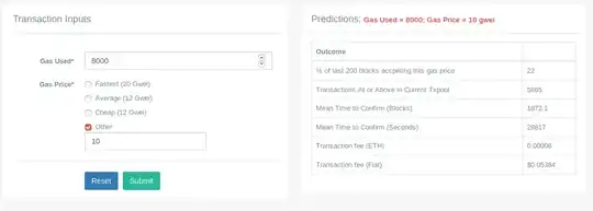

You can also approximate the time using the Transaction Calculator, your transaction will execute 80 000 units of gas at a price of 10Gwei. They estimate to 28 817 seconds (8 hours)
