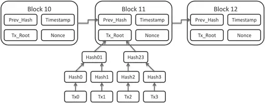

The blockchain is the key data structure at the heart of decentralised networks like Ethereum and Bitcoin, and it looks a little bit like this:
Blockchain diagram
It consists of a series of blocks, each linked to the previous block by means of a cryptographic hash (which guarantees that no previous block or its contents have been changed) and containing a set of transactions from network participants which are being added to the permanent record of what has happened. By carefully enforcing the rules for what constitutes a valid transaction or block, the network is able to both ensure and prove to any observer that the resulting "state of affairs" is agreed upon by the entire network.
Different blockchains have slightly different structures, and Ethereum's actual blockchain structure is somewhat more elaborate than this picture shows, but that should be enough to give you the basic idea of what a blockchain is.
