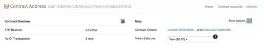

  1. first I deployed a ERC20 contract to Ropsten network. The fallback function like following.

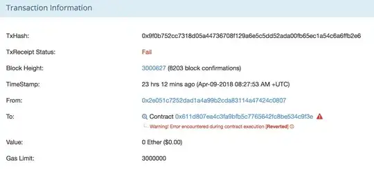

  2. I send 0.5 ETH to my contract address and contract received 0.5 ETH. as deadline is up, I send 0 ETH to my contract address to trigger contract's fallback function transfer ETH balance to beneficiary. But it's failed. And in ropsten.etherscan.io it prompts 'transaction revert' . contract link: https://ropsten.etherscan.io/address/0x611d807ea4c3fa9bfb5c7765642fc8be534c9f3e

after I review my contract code, I found that cause this error is due to the accuracy of exchange ETH and token.
eg. When sender's ETH amount is less than 1, the contract would give sender 1 token, after contract deadline terminated, contract need to send token balance to beneficiary. Actually
tokenBalance = tokenTotalSupply - 1
But I regard this situation as
tokenBalance = tokenTotalSupply - 0
So there is not enough tokenBalance transfer to beneficiary.
