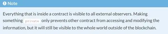

Any contract code deployed to the blockchain can be read/viewed by anyone. This includes variables/functions declared private The only thing private does is restrict access of that variable/function to the contract it is declared within.
From the docs:enter image description here
Zack McGinnis
  • 791
  • My question is asking for someone to show the steps for viewing the an arbitrary state variable marked private. – nipponese Apr 05 '18 at 20:20
  • In this case, you would need to view the contract code/ABI on etherscan, and determine the value of the variable on your own. – Zack McGinnis Apr 05 '18 at 20:26
