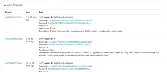

The EtherScan.io website provides a page for The DAO proposals.
This page does not provide the current voting status. How can I view The DAO proposals including the current voting status?

EDIT 03/06/2016 - Updated list of sites providing the list of The DAO proposals
You can view the list of The DAO proposals with the current voting status at:
