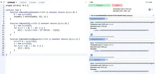

Here's a comparison of the gas used in the three methods by @NickJohnson, @Eth and @k26dr. I've added a constant to the function modifiers as these functions do not alter the blockchain:
pragma solidity ^0.4.2;
contract Test {
function toBytesNickJohnson(uint256 x) constant returns (bytes b) {
b = new bytes(32);
assembly { mstore(add(b, 32), x) }
function toBytesEth(uint256 x) constant returns (bytes b) {
b = new bytes(32);
for (uint i = 0; i < 32; i++) {
b[i] = byte(uint8(x / (2**(8*(31 - i)))));
function toBytesNicolasMassart(uint256 x) constant returns (bytes c) {
bytes32 b = bytes32(x);
c = new bytes(32);
for (uint i=0; i < 32; i++) {
c[i] = b[i];
You can see the gas cost of running these functions in Remix (Solidity Browser):
