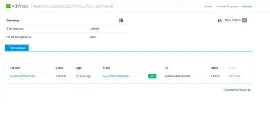

I am trying to deploy contract on ropston testnet. I have created an account through truffle console and got three test ethers from https://faucet.bitfwd.xyz/. I have confirmed that my account has three ethers from this https://ropsten.etherscan.io/. But when I check balance from truffle console it always says zero. Although my node is synced.
web3.eth.getBalance('0x06ac473de96986b20b37f13ca311d07c0875e49b') BigNumber { s: 1, e: 0, c: [ 0 ] } here is screenshot of https://ropsten.etherscan.io/ which clearly shows it has three ethers.

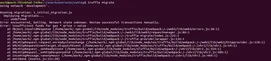

When I do truffle migrate I get following error. enter image description here

Are you sure truffle migrate tries to migrate to ropsten ( with an e) ? It says "using network development" in your screenshot. You should have ropsten declared as a network in your truffle.js.
So: Please check wether you a) are checking your balance on ropsten via truffle console, and b) wether you are actually trying to migrate to ropsten.
Edit: I added Ropsten like this into my truffle.js :
ropsten:  {
     network_id: 3,
     host: "localhost",
     port:  8545,
     gas:   450000
Then migrate via truffle migrate --network ropsten
Regarding the balance, please check Why the balance that I see in the Ropsten isn't reflected in Truffle console? and make sure you really are in sync.
