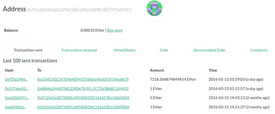

Patrick used the Ethereum Wallet to transfer 1 ether to test out buying TheDAO tokens on his mining computer. When (so far it seems that) Ethereum wallet unlocked his geth wallet for 2 seconds (via the IPC API, not exposed to the Internet), a bot that was watching his geth wallet activity swooped in to send a transfer instruction to geth (via JSON-RPC, exposed to the Internet) and transferred his remaining 7218 ethers into the hacker's account.
Here is Patrick's account showing the 1 ether transfer before the removal of his remaining balance ~ 17 seconds later (0x95a3ba0aabc6296cbbe3862a889ecb37979da493): enter image description here

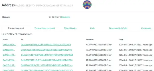

Here is the hacker's account showing the 7,218 ethers being split into many fragments of 97.54489533580829 ether transactions (0xc5d431ee2470484b94ce5660aa6ae835346abb19): enter image description here

The 1 ETH transaction occurred at 2016-05-12 03:12:57. The 7218.368874849814 ETH transaction occurred at 2016-05-12 03:29:03, ~ 17 seconds after the 1 ETH transaction, which is the 2 second window + the average ~ 15 second Ethereum blocktime.

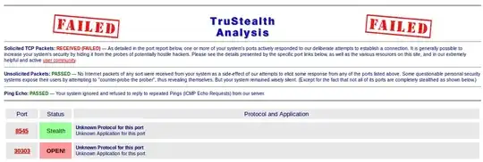

9. Test For Open Ports On Your Internet Connection
Use a service like GRC to probe for the open ports on your Internet connection. Click on grc.com, click on Shields UP!!, then click on ShieldsUP! again. Read the text and click Proceed.
On the web page shown below, I've typed in ports 8545, 30303 and clicked User Specified Custom Port Probe:

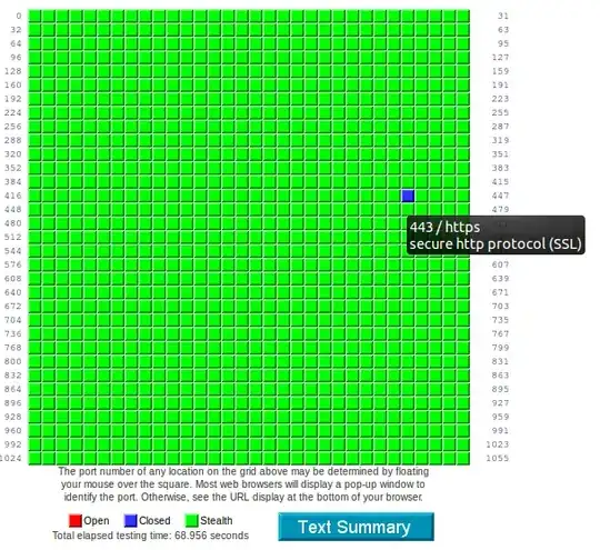

The probe results are shown below - Port 8545 (geth RPC) is not open to the Internet while port 30303 (Ethereum P2P port) is: enter image description here
It's probably a good idea to test All Service Ports (Ports 0 to 1055) at the same time to confirm which ports you have open. The following results show that I only have port 443 (HTTPS) open: enter image description here
