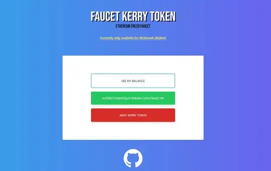

I released a new ERC20 Token Faucet hosted on: https://www.erc20tokenfaucet.com/
This is the Github repository: https://github.com/Kerry1207/ERC20TokenFaucet
It's a simple web application with two functionalities:
  • See My Balance: It's a feature that querying the Kerry Token smart contract and allow you to see over the ERC20 token information also your Kerry Token balance;
  • Minting Kerry Token: It's a feature that permit you to minting a 1 unit (this is a constant) of Kerry Token without restrictions.
This is a screenshot of website: enter image description here
