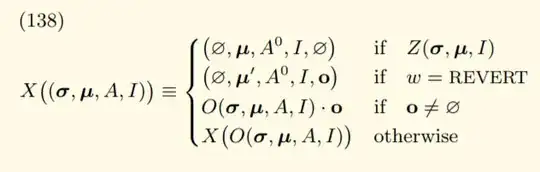

No, when a revert occurs, the transaction state changes are thrown away, including any event logs.
This behaviour is defined in the Yellow Paper here:
The A0 bit when w = REVERT is the formal version of what I said above: no logs are recorded in the case of a revert.
If you are running your own node, of course you can do whatever you like. Geth, for example can provide very detailed transaction traces that you can look at and see what happened even for aborted transactions. But none of that will get stored on the main blockchain.
