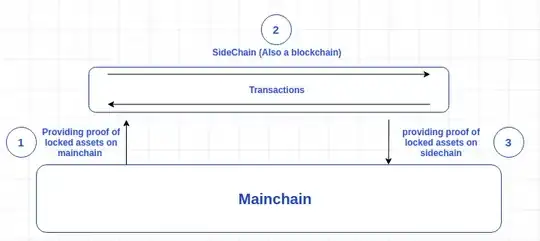

A sidechain is a separate blockchain that is attached to its parent blockchain(mainchain) using a two-way peg.
In other words, you can move assets to the sidechain and then back to the parent chain. sidechain
The two-way peg enables interchangeability of assets at a predetermined rate between the parent blockchain and the sidechain. The original blockchain is usually referred to as the ‘main chain’ and all additional blockchains are referred to as ‘sidechains’. The blockchain platform Ardor refers to its sidechains as ‘childchains’.
A user on the parent chain first has to send their coins to an output address, where the coins become locked so the user is unable to spend them elsewhere. Once the transaction has been completed, a confirmation is communicated across the chains followed by a waiting period for extra security. After the waiting period, the equivalent number of coins is released on the sidechain, allowing the user to access and spend them there. The reverse happens when moving back from a sidechain to the main chain.
