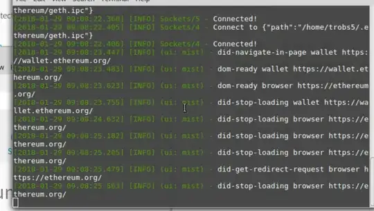

Initially, the regular sync would not download the last 200+/- blocks or so. I was told to switch to light sync where it finished. I then read that to start mining real ether on the main network, I need to use geth here:
I don't see "Start Mining" option?
mist geth
After typing the command abolve into the terminal, I got the following:
Terminal after typing mist geth
My issue is, how do I know if I am mining ether or not? Or is there another step I am missing?
