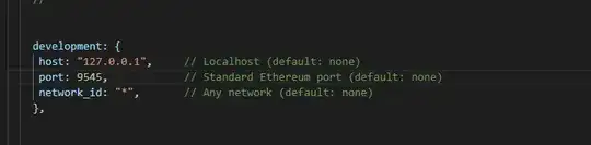

    testrpc listen default port 8545, truffle develop port is 9545, I change
    8545 to 9545 in truffle-config.js, but how can I change testrpc port ?

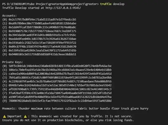

truffle develop should be executed before deploying any contract.
Rady
  • 121
After running the Ethereum development server look in which port it is running.enter image description here
And the change in truffle-config.js as follows enter image description here

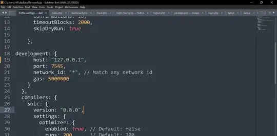

Open Ganache and check RPC SERVER HTTP://127.0.0.1:7545
Open truffle-config.js
Now change this truffle-config.js according to the above port no
// development: {
    //  host: "127.0.0.1",     // Localhost (default: none)
    //  port: **7545**,            // Standard Ethereum port (default: none)
    //  network_id: "*",       // Any network (default: none)

Check the parameters of your Ethereum client by:
Confirming whether the port displayed in your terminal is similar to the one in the "truffle-config.js" file. The 2 port numbers should be identical.
