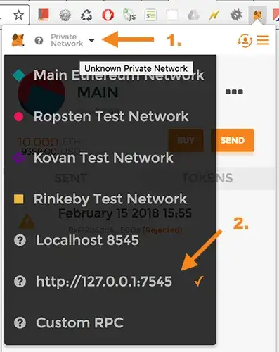

E.g: if you are using Ganache (previously test-rpc) make sure you Metamask points to the right network to see the founds:
You may use truffle console to send founds from your (unlocked) addresses to any other address on the same network.
