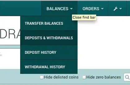

Poloniex
  1. Login to your Poloniex account
  2. In the upper right, look for the “Balances” drop down:
Balances
  1. Click Deposits and Withdrawals
  2. Scroll down until you see ETH and click "Withdraw" over on the right hand side.
  3. This will pop down a menu-thingy.

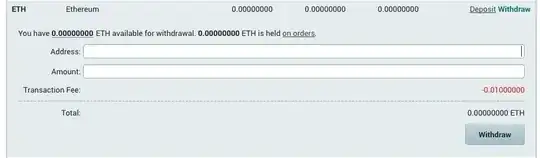

Withdraw
  1. Enter your address and the amount you would like to withdraw. Then click the WITHDRAW button.
  2. Poloniex will now send you an email. Open you email and click the link they provided.
  3. You will taken to a "WITHDRAWAL CONFIRMED" page.
  4. Type your address into Etherchain or Etherscan to see if the transaction made it. For some reason, it sometimes takes a couple more minutes than usual on Poloniex. You can check the status on the deposit/withdrawal history page.
