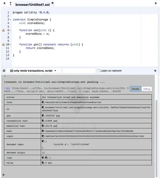

I think you may be alluding to the online remix compiler for Solidity. This will allow you to see easily how much gas a transaction to a function will need/spent.
If you execute a state changing function then inspect the details of the transaction you'll get more information. Please see the example below:
Here we can see trasaction cost & execution cost. Everything you need. Hope this helps.

  • thank you! I think that's exactly what I was looking for. I've edited my original post and added a specific use case just before I've seen your answer. To understand, in a case when the gas consumed by calling a method changes depending on certain conditions is there a way to check the maximum gas consumed - suppose method says: if before block number X do A (which would consume 100000 gas) and if after block number X do B (which would consumes 150000 gas)? – Amit Dec 12 '17 at 17:53
  • Cool, do you want to mark the question as answered so that other users know? To test that exact case I'd look at either manually creating blocks by sending many transactions or change the Environment used to have your own provider i.e. Injected Web3. This way you'll be able to control more accurately how many blocks you're at. You should be able to test block height conditions easier this way. – Malone Dec 12 '17 at 18:04
