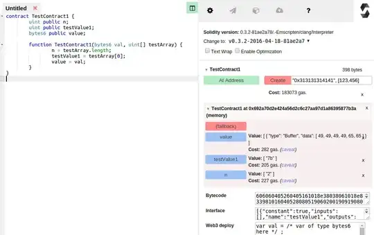

It may be a Geth bug because a quick test in Solidity Browser appears to work correctly .

  • Looks indeed as a bug in Geth. I noticed that I was running an old version of the solc compiler, but updating that to 0.3.2 resulted in same error. – hatemp Apr 22 '16 at 08:06
