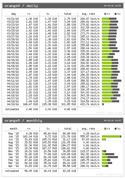

In the daily chart below, the average data transfer rate seems to be between 200 and 358 Kbits/s.

Note - my estimates below are based on the raw bytes received and transmitted by my Ethernet networking cards on my mining computers and will include other traffic travelling within my internal network. It should be an over-estimate that will give you an upper limit.
Ethereum Mining Network Traffic
In the chart above, the daily traffic of 2.46 GiB received and 2.00 GiB transmitted would be a good representative of my Ethereum network traffic consisting of traffic from an instance of the geth blockchain node software and 2 instances of the ethminer mining software. My ethminer mining software has mainly been mining solo, but sometimes is pointed to mining with a pool.
In the monthly chart, the months of December 2015 to March 2016 would be representative of the Ethereum network traffic.
My monthly estimate from the charts above would be between 32 to 54 GiB downloads and between 25 and 91 GiB uploads, with the total transfers between 73 and 141 GiB.

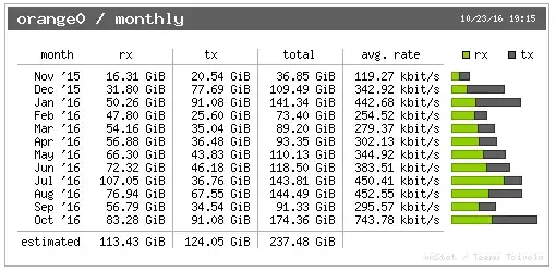

Update Jan 31 2017
As requested by @gatb27, here is an update of my miner's network traffic. Note that my firewall reporting stopped sometime in October 2016, so the charts only display the data until then.

    @gatb27, I've updated the network traffic chart, but my firewall stopped collecting data in Oct 2016 (usual upgrade breakage). – BokkyPooBah Jan 31 '17 at 02:04
