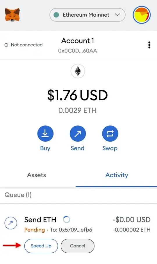

A pending transaction can be cancelled by using a wallet that supports it.
For example, here are instructions from the MetaMask wallet with diagrams.
https://metamask.zendesk.com/hc/en-us/articles/360015489251-How-to-Speed-Up-or-Cancel-a-Pending-Transaction
Click the Cancel button. The other answers explain more about what happens behind the scenes.
