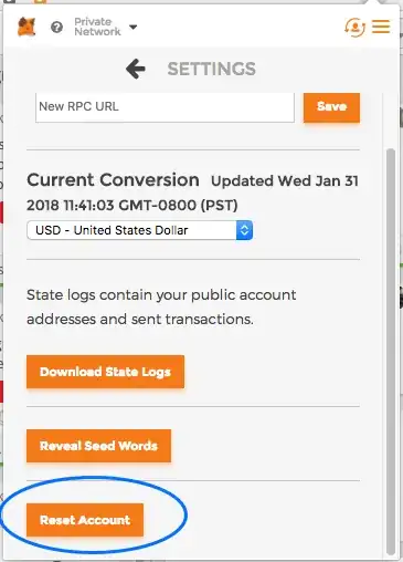

There is a new feature in Metamask for this:
https://consensys.zendesk.com/hc/en-us/articles/360004177531-Resetting-an-Account-New-UI-
Arash Kiani
  • 113

Starting from MetaMask v3.14.1 you can reset your account as follow:
Resetting an Account In the Settings menu, MetaMask has a "Reset Account" button. This button wipes the current account's transaction history, which is used to calculate the current account nonce.
Normal users should never have a reason to use this feature.
This is useful for developers who reset a test network but want to continue using the same account, forcing MetaMask to believe this network ID is a clean network in a fresh state.
Ref: http://metamask.helpscoutdocs.com/article/36-resetting-an-account
Copied from https://stackoverflow.com/a/47429502/8303489

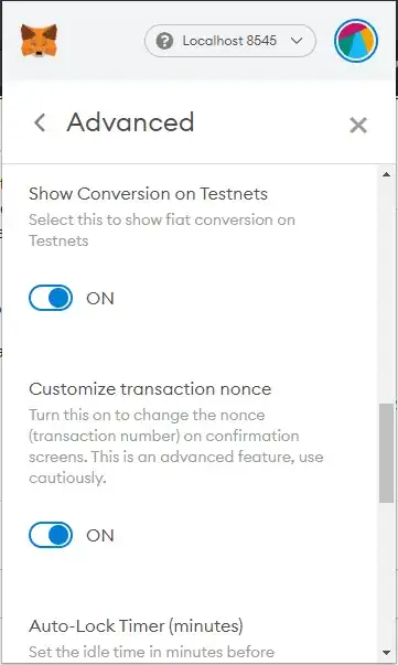

I would like to add one more solution as none of these had worked for me.
I clicked on the Metamask chrome extension then went to My Accounts > Settings > Advanced > Reset Account. This resets the accounts transaction history but won't change the balances or require you to re-enter your seed phrase.
In the MetaMask setting > go to advanced setting > turn on custom nonce.
MetaMask-Advance_setting-custom-nonce
After turning on Custom nonce, you can add your custom nonce before making any transaction.
MetaMask-custom-Nonce
The custom nonce should be the account nonce. Here in this case it is 4. (you can get the account nonce in the error)
If this works for anyone please let me know.
