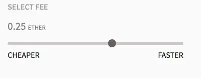

Lately, I've seen wildly varying transaction costs when using Ethereum Wallet. How is the fee range computed?

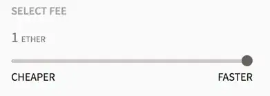

  • "transaction fees are relayed back" Not sure I really follow. Does this mean that someone running a Ethereum miner is intentionally setting ridiculously high prices perhaps in hopes that new users will fall for it? I'm seeing even higher fees now, up to $720 to transfer $20 between accounts. https://imgur.com/a/tEUYV –  Nov 22 '17 at 00:00
  • What I mean by "transaction fees are relayed back", is that you're client implementation of the Ethereum protocol (Geth) will calculate the fee and then send it back to the user for them to see. The slider that you reference in the image isn't very accurate. You could choose the minimum fee where the scroller is closer to "cheaper" and you'll still get the transaction mined quickly. Miners aren't trying to trick anyone. I'm aware that the Mist GUI isn't very intuitive and naive users may end up paying more tx fees than necessary! – Malone Nov 22 '17 at 00:06
  • Say a naive user buys a couple Ether and attempts to send a small amount, not understanding that the simple slider and values can have wildly varying amounts at different times. Who gets the $720 for the small transfer? Is it possible for such a mistake to be rectified? –  Nov 22 '17 at 00:46
  • @MichaelPrescott ive done a little digging around and found out that this is a bug in the Mist GUI see: https://github.com/ethereum/mist/issues/3002 - They aim to address it in v0.9.4. Id suggest showing some support on that issue. Other people asking the same questions as you, they’re wondering will it actually charge you that ridiculous tx fee if you accidentally selected it. Good issue, well spotted. – Malone Nov 22 '17 at 00:56
