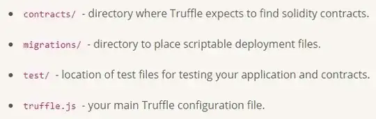

If you are working on private network during test and development phase use truffle its best, if working on testRPC or Geth. Just follow the follwing steps
  1. open Console window and run this command npm install -g truffle
  2. create a project directory and run this command inside it truffle init
  3. it will create the follwing folder structure enter image description here
  4. in truffle.js define your network configruation like this
  module.exports = {
  networks: {
    development: {
      host: 'localhost',
      port: 8045, // your can use your port number
      network_id: '*' // Match any network id
  1. then in migration folder delete other files except 1_initial_migration and create another js file with the name 2_deploy_contract.js with the follwing contents
var MyContract = artifacts.require("MyContract");
module.exports = function(deployer) { // deployment steps deployer.deploy(MyContract); };
  1. open a console in the project directory and run the command truffle compile
  2. the run this command truffle migrate --reset, during this operation keep your miner in running condition. At the completion it will give a message contract successfully depolyed. And in the build folder you can check yourcontract.json file is created. So in future just reference it.
  3. now open console and run this command truffle console
  4. then run this command yourContractName.address, it will give your contract address.
