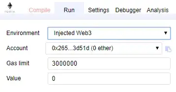

With Remix IDE, the browser IDE of solidity, You have two options for this.
- Use Injected web3 with a service like metamask (you have to install the browser plugin) and connect to a test network.
- Use JavaScript VM to test smart contracts without actually deploying it to a network.
All what you have to do is to select the environment to be JavaScriptVM or InjectedWeb3.
