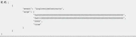

The log file created using event is shown below. Is it possible to show the variable names of the fields that the values are being displayed.
Log File

  • Just to clarify, do you want the hex values in string? Or do you want the variable names printed out with it? – thefett Oct 02 '17 at 11:05
  • Hi @thefett, thanks for your reply. I wanted to see the variable names printed out with it. Is that possible? – userDSSR Oct 02 '17 at 14:59
Just change the event to place the name first:

  • Hi @thefett. This works for now but in a round about way. The variable name and the value falls in two separate lines and it requires the variable name to be hardcoded again in the event execution. I was trying to get the same format as the "decoded input" in the Log file, which has the variable name along with the value. I am not sure if that is possible for now. – userDSSR Oct 02 '17 at 16:28
  • Ah I see, I don't think it is possible without hardcoding it. The 'logs' portion is just the decoded logsBloom which you can see here: https://ethereum.stackexchange.com/questions/3418/how-does-ethereum-make-use-of-bloom-filters is just stored data, so if you don't specify what you're storing, then it can't figure it out from just the logs data – thefett Oct 02 '17 at 17:38
