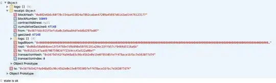

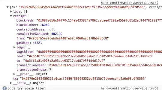

So I'm using truffle to call a deployed contract. PlayerA and PlayerB are simultaneous calling the contract. If I just rely on a successful transaction and don't explicitly check the state only the state change of one player is actually persisted. I use two different browsers for each player. The following pseudocode is used to call the contract and then check the change. Retrying after checking if the change actually is present does get the others player number in the contract and then the dosomething part is called.
contract.playANumber(1, {from: "someAddress"})).then( (tx) => {
                                 console.log(tx);
                                 return contract.getTheNumbers.call({from:"someAddress" });
                            .then( numbers=>{
                                if( (numbers.A > 0 && iAmPlayerA()) ||
                                    (numbers.B > 0 && !iAmPlayerA() ){
                                    console.log('state is ok');
                                } else{
                                    console.log('oops try again later');
Output of Player A:
Player A output
Output of Player B:
Player B output
