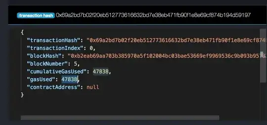

Here's a simple string of 1 GPS location data $GPGGA,053855.33,3756.9296,N,12737.8335,E,3,08,0.0,0.0,M,0.0,M,0.0,0000*74
Let's make a simple contract to store this: https://ethfiddle.com/rM9HRNhsF8
So storing that single string costs roughly $0.021 USD. And you wanted to do this frequently for thousands of users....?
Hate to be the guy to tell you no, but what you really need is an application-specific sidechain running on Ethereum and not running your DApp on Ethereum itself.
