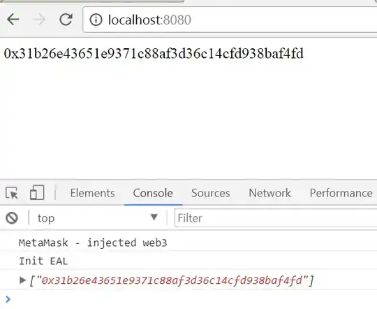

If you are using web(version 0.19.0: latest stable), you can do
1. Download Web3
bower install web3@0.19.0
2. Algo to load Web3, check the connection and retrieve the accounts
<html>
<body>
    <div id="address"></div>
    <script src="bower_components/web3/dist/web3.min.js"></script>
    <script>
        window.addEventListener('load', function() {
            // Load WEB3
            // Check wether it's already injected by something else (like Metamask or Parity Chrome plugin)
            if(typeof web3 !== 'undefined') {
                web3 = new Web3(web3.currentProvider);
            // Or connect to a node
            } else {
                web3 = new Web3(new Web3.providers.HttpProvider("http://localhost:8545"));
            // Check the connection
            if(!web3.isConnected()) {
                console.error("Not connected");
            var account = web3.eth.accounts[0];
            var accountInterval = setInterval(function() {
              if (web3.eth.accounts[0] !== account) {
                document.getElementById("address").innerHTML = account;
            }, 100);
    </script>
</body>
</html>
3. Auto-reload after switching account
The solution right now is a basic setInterval function
Greg Jeanmart
  • 7,207
  • 35
  • thanks for the answer. But, don't you think we're setting the account as account[0]. Assume we switch to account[1] in MetaMask, then how web3 (in .js file) can detect it and set account=account[1]? Am I right that your answer explains: how we can set user's account to account[0], but it doesn't show how we can get the user's current address? (assume we manually set the account to account[1] in MetaMasK browser extension.). Thanks – Aydin Sep 11 '17 at 19:57
  • I don't know if you have seen the update. But the array always contains one element which the current metamask address. – Greg Jeanmart Sep 11 '17 at 19:59
  • To pull a change. A setInterval function does the job – Greg Jeanmart Sep 11 '17 at 20:00
